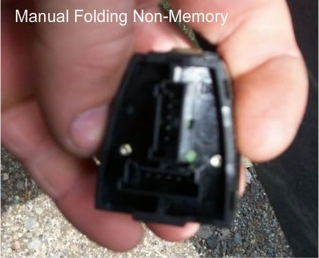

If your pre-3/2003 E46 BMW has NO Memory and Manual Folding Mirrors. This is ALL you will find on your car for Mirror Control;

My Memory Seat Buttons:
My Door Panel Mirror Adjust Switch (just pry the top and botton end with a butter knife and it easily pops off):
The underside of the switch revealing that it is indeed the blue/turquiose color that it should be to indicate I have a manual folding memory set up:
So that means I have the correct switch and also the in-door Mirror Memory Modules already so I would only need to buy the Power Fold Switch and the R and L power Fold Mirror Units.
And If you want to upgrade your Non-Memory/Manual Folding Mirrors to Non-Memory/Power Folding Mirrors then you need to buy Non-Memory type/Power Folding Mirrors and these things then you will have to get your car programmed at the dealership;
But if you want to upgrade your Non-Memory/Manual Folding Mirrors to Memory Power Folding Mirrors then you need to buy the Memory Power Folding Mirrors (even if they are Aftermarket M3-Spec) and these things and you may need do a 6 pin to 12 pin conversion and/or get your car programmed at the dealership;
