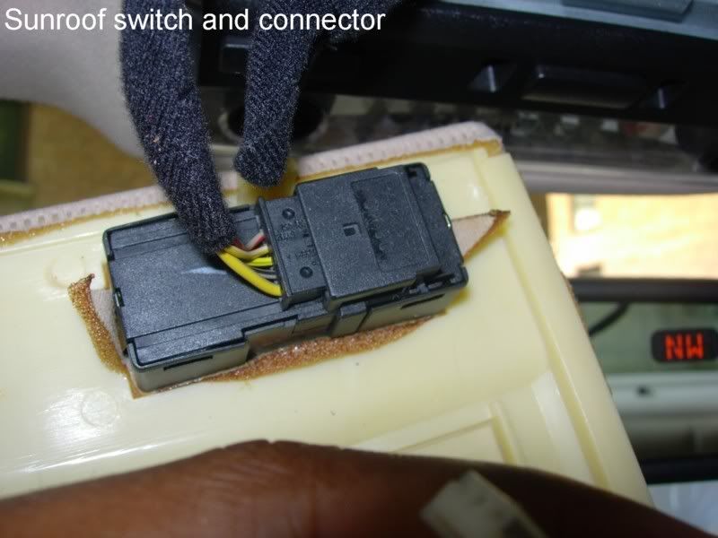

Your Homelink wire harness will be wrapped up in black velvet tape and should be tucked in towards the passenger side of the car. I had to dig pretty deep to get mine out. Be careful not to damage the sunroof motor parts.
View of BMW E46 E38 E39 E53 Sunroof harness and switch from the back.
And lastly we have this this flat wide white connector in there which I have NO IDEA what it is for; either a Bluetooth related device (ie. Microphone) or the BMW SOS Assistance Module.
Before you cut into your car please be sure that the part you just bought off eBay works and more importantly works with your car
