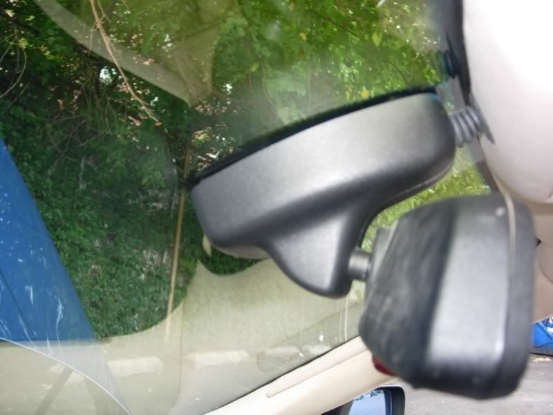

Start the DIY by removing the current mirror. The rain sensor housing un-couples from the center. Press your opposable thumbs against them and spread the shells apart. It should give you no trouble whatsoever.
Underneath you will find the mirror's neck and, if you have it, the rain sensor module that sits against the glass and away from the mirror. So don't touch it.
Next up you will un-clip the old mirror's connector from the E46 in-car-connector and remove the mirror from the car. Swivel the neck on the top hinge towards the passenger side until it pops out. It may be stiff so give a slow firm pull. The Dealership's DIY Manual says turn it about 45 degrees to release it. Again it should give you no trouble.
