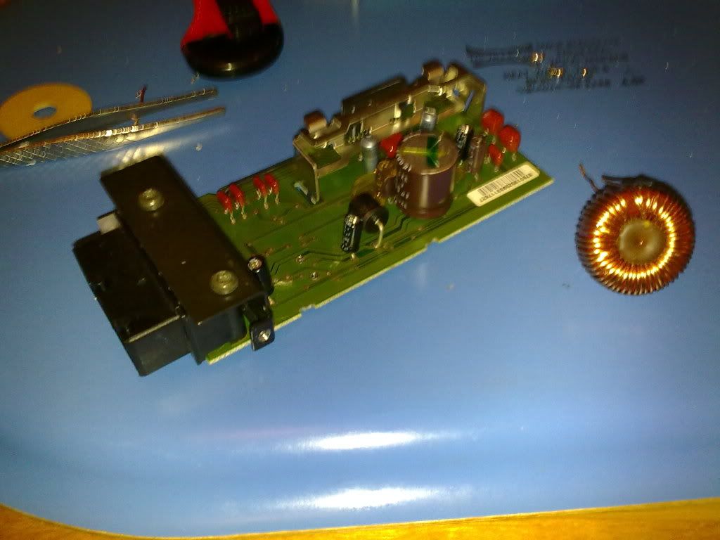

Problem solved,dismantled amp to look for internal fuse,discovered that the coil had broken away from the pcb,prob from vibration,repaired and re-soldered the component works perfectly now many thanks for all your help really appriciate it,i have posted pics of what i discoved below.

I just pulled my amp apart and found the same thing. did you add some new copper wire to fix it? I'm trying to figur out how to do it without iot breaking again. Looks like you may have unwound the wire enough to give you some good leads. How did you attach the coil to the board? perhaps some epoxy? It looks like the factory didn't use any glue, so the wires just broke from the weight of the coil. Thanks for any advice! :emo

OK, just pulled apart the coil, unwound each lead a half turn, flipped it over, and resoldered to the PCB. Used Superglue (I'm sure the wrong thing, which I will regret) to secure the disc to the PCB, and put her back together. I've had the car 6 years, and the sub was never working! Sounds great, now! Thanks for the post, even if it's a year old!

I did the same,I removed the disk base to the coil with a flat screw driver carefully and unwound each coil a half turn,then i used araldite two part epoxy(which is a resin type of glue and drys v hard)to stick the disk to the coil,left for a few hours to harden properly then resoldered to the pcb,I did't stick the disk to the pcb because i was'nt sure if the resin i was using was going to effect the circuitry on the board,am sure what you have done will be fine.

Hi all, I have the same problem but made it worse by accidentally breaking the copper wire. Anyone knows which typ of toroid inductor I need to replace the old one?
