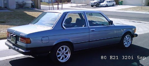

Would you happen to know what size nut goes on the inside bumper mounting bracket?
(two on each side).
I just got my 80 320i last week and after inspection behind the bumper, I noticed all of those nuts are missing.
