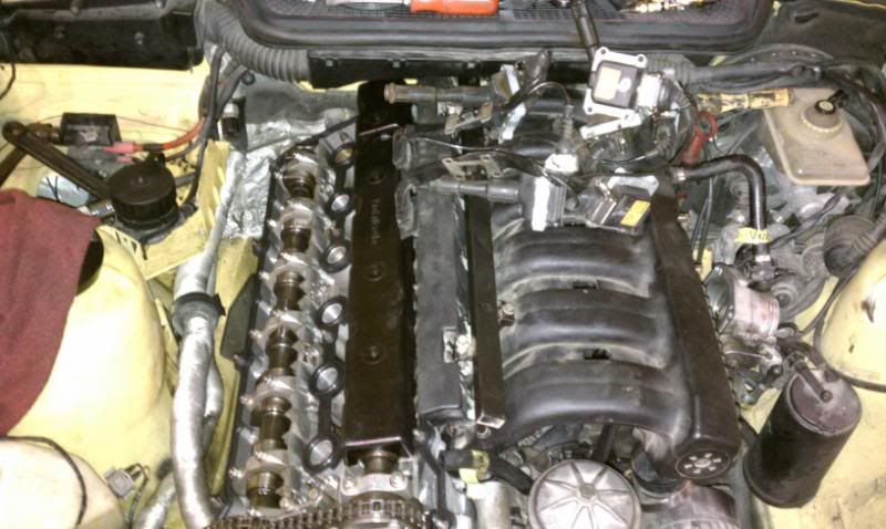

valve cover removed in prep for the head removal.

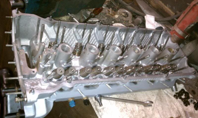

Head when it came back from the machinist. Valves were lapped as well as head was decked so the thicker headgasket would have a nice mateing surface. LEAKS ARE BAD

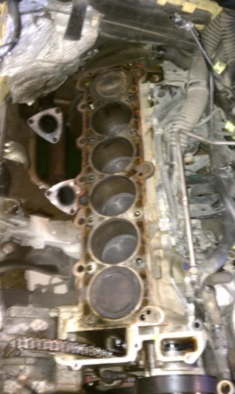

Block pistons and such after head removal

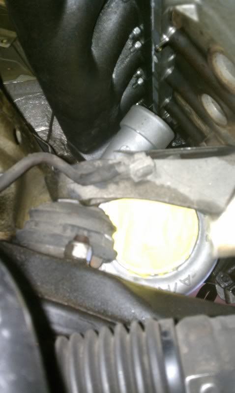

first look at turbo fitment before TRM motor mount was installed.

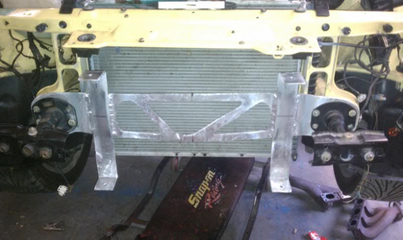

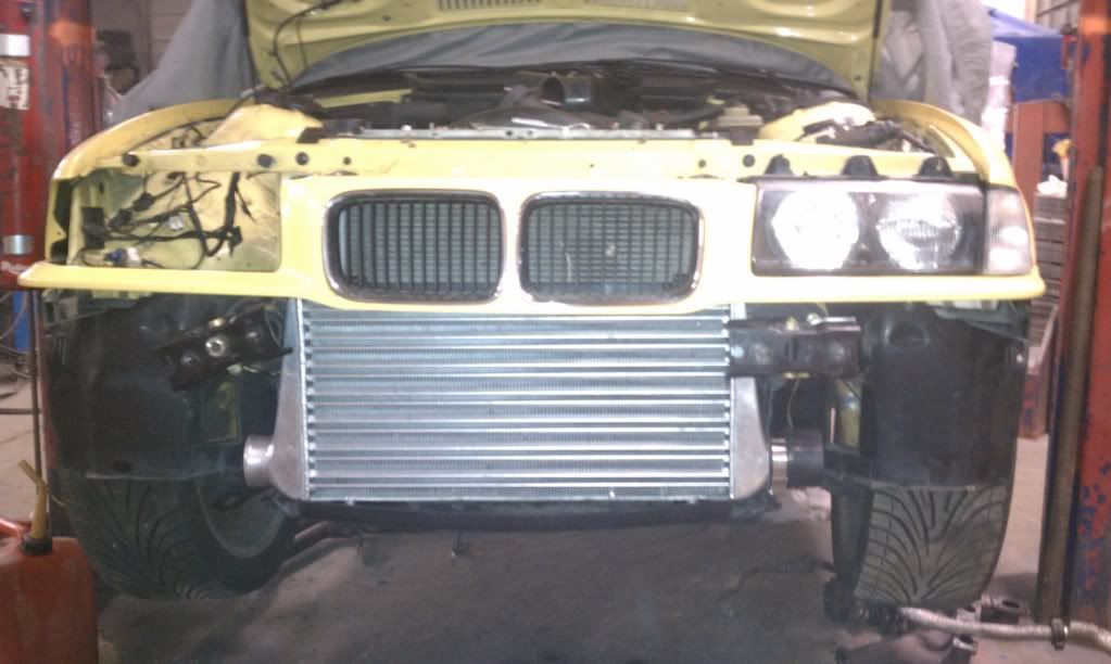

Aluminum bracket fabbed up for the intercooler

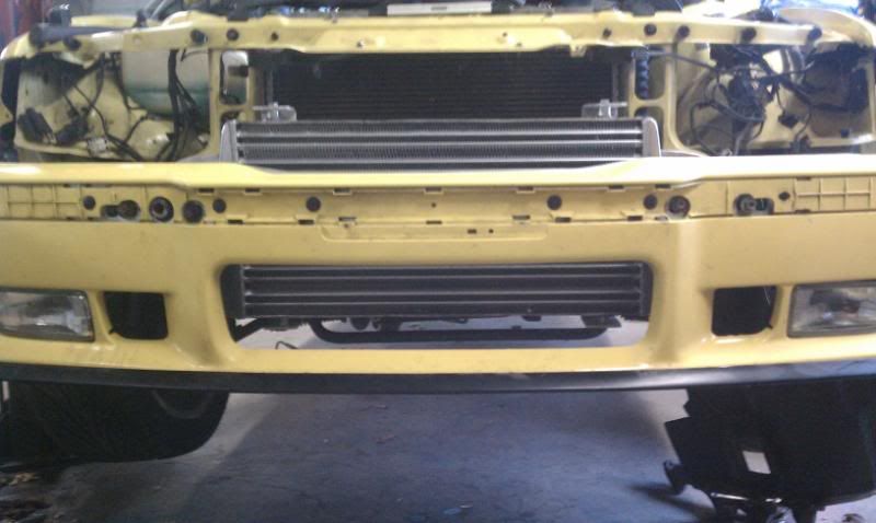

original fittment of the intercooler.

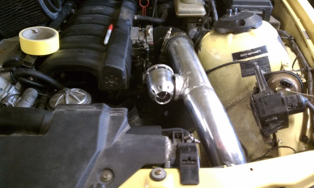

Elbow and BOV
After I moved it down 2 inches.

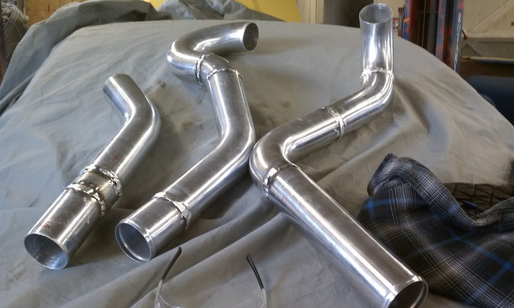

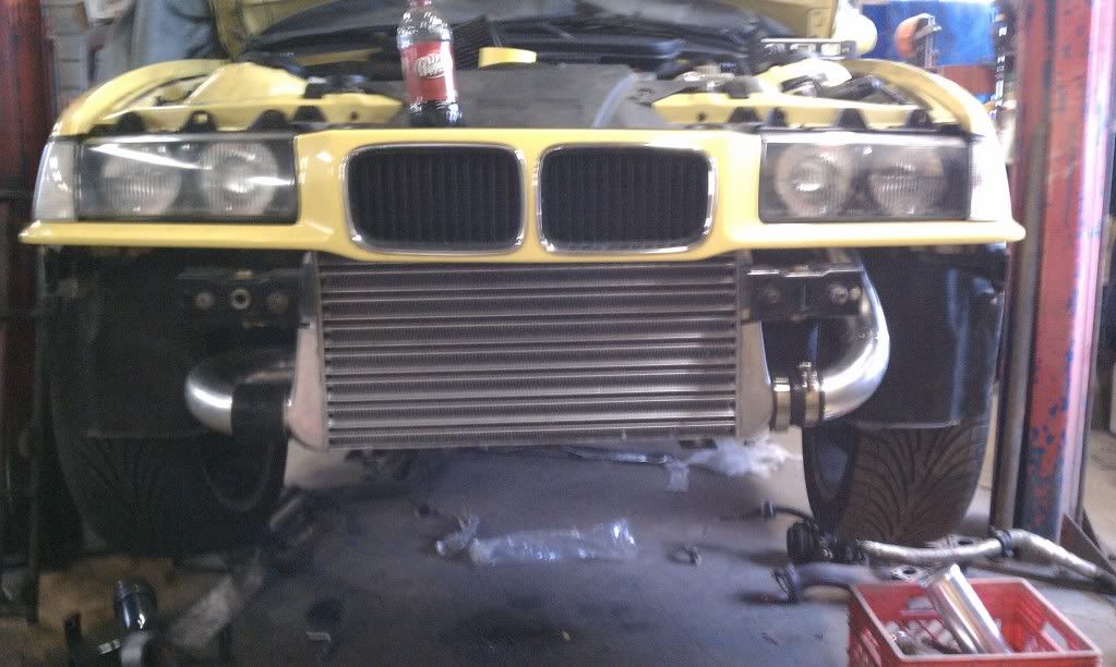

intercooler piping finished
BOV welded in and mounted.
second fitment and welded up piping installed.

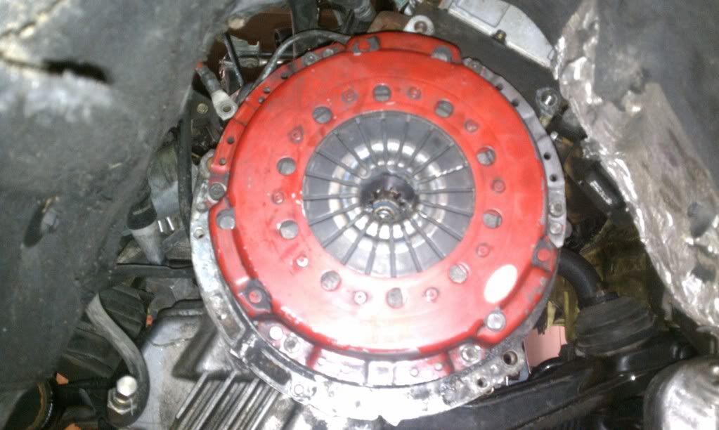

clutch rated for 600 ft lbs

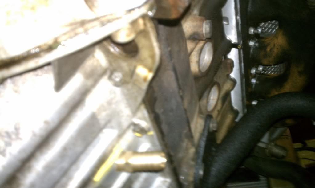

oil pan drilled and tapped with fitting installed for oil return line.
