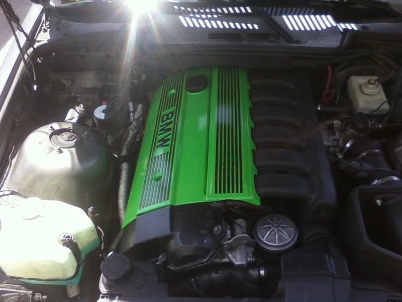

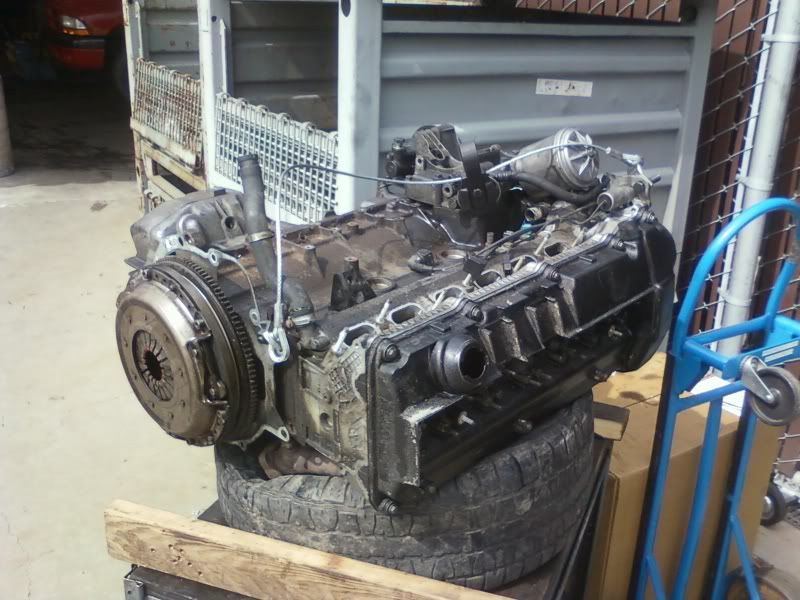

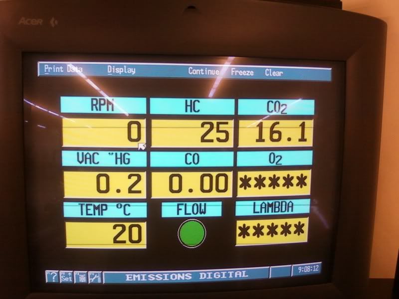

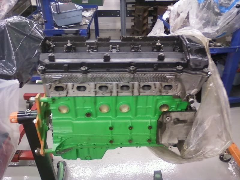

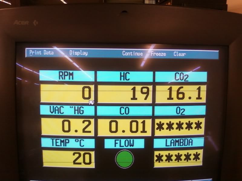

I took the 2.5l engine i put a 2.8 crank, rod, and piston assembly in the m50 block along with s52 cams, injectors, exhaust manifold, and m3 sachs clutch set. Next I also used m52 springs with the head. Here is the car dyno tested before the s52 injectors installed. The car put out 188.3 peak hp and 179.4 peak torque at the wheels. I calculated it out to be around 230hp at the crank. It is way faster after that install. Now this is the covers after i painted them and they look awesome. This is a pic of the 4-gas analyzer during a two speed idle test @ 1500 rpm. This is the second part of the test at 2500 rpm. Now just waiting for the new vanos and the car is ready to rock. Let me know what u guys think.
